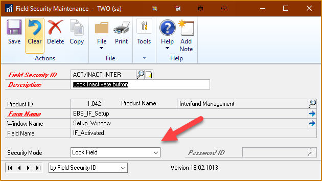

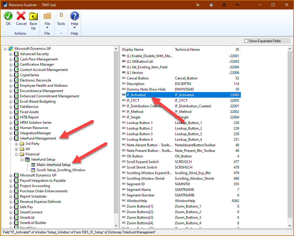

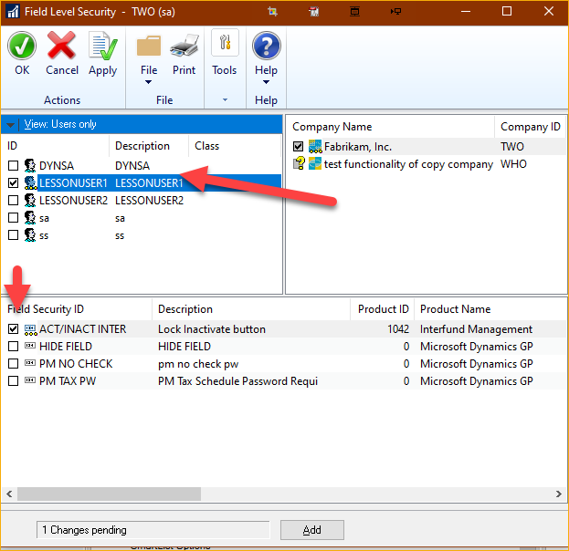

      It certainly is, I tested this and here are the settings I used:
      Here is a drill in to how I set it up
      Assign it only to the user(s) you want it to affect
      It will then immediately be locked for users to be unable to change.
