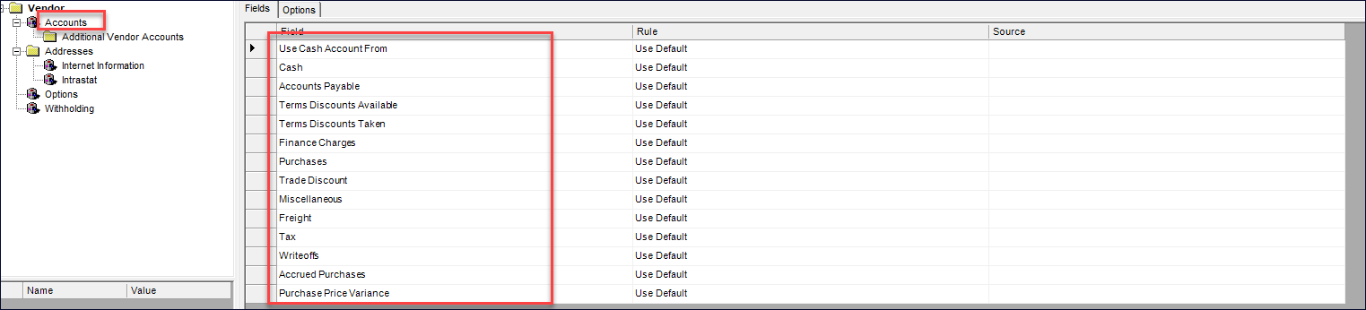

      With that said, to use Integration Manager to accomplish adding the accounts to the vendor card for default, run a smartlist of your vendor list to Excel, add the distribution account(s) ??- A separate column for each type of account such as Purchases (this is your expense account), Accounts Payable, Discounts, etc.Ā  Here is a list of the available account types.Ā  Again, make your column headers these exact words and map them this way.
      You’ll have to change the Rule to Use Source File and the click on source and select the column with that vendors account for that account type.
      If you don’t want to map all of them, just leave the rule at Use Default.
