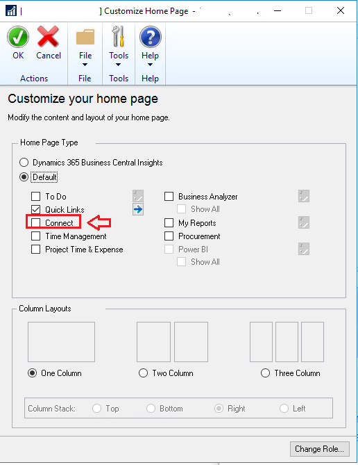

      Can anyone save me some time and send me the SQL to uncheck this “Connect” option for all users?
      I’ve traced through the SY081xx and SY01402 tables and am just not seeing it.
      GP 2018 R2

      But here is the SQL for ALL Users…
      UPDATE [DYNAMICS].[dbo].[SY08100] SET [Visible] = 0 WHERE [SectionID] = 6

      Thanks for the script! I guess I was a little data blind yesterday. I must have looked at that able 20 times, flipping back and forth.
      Later in the day I found this reference.Ā
      –https://www.azurecurve.co.uk/tag/microsoft-dynamics-gp-fall-2020-release/page/2/
      The column number setting is held in the syHomePageLayout (SY08100) table in the system database; the SectionID column will contain the following values:
      1 = To Do
      3 = Business Analyzer
      4 = My Reports
      5 = Quick Links
      6 = Connect
      7 = Time Management
      8 = Procurement
      9 = Project Time and Expense
      10 = PowerBI
      The Column Stack setting is held in the syHomePage (SY08000) table, the ColumnStackPosition column will contain the following values:
      0 = Top
      1 = Bottom
      2 = Right
      3 = Left
