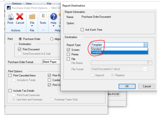

    Using GP2018 (latest versions). Is there a way to set a default, so that the DEFAULT is to Standard and not to Template? On GP2015 we did not have Template as an option. Our fingers do not look to see that a report is defaulting to Template.

    Have your seen this article? It walks through the steps and does mention “…This will change the Report Type default back to Standard. Users can still select Template as an option if needed.”
    Disable Word Templates in Dynamics GP for Printing

    Thank you. I just took the option to turn off all templates. The Standard has worked well for what I do.
