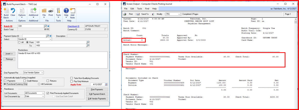

      Have you tried unmarking the “Print Previously Applied” checkbox (in addition to unmarking the “Automatically Apply Existing Unapplied”)?
      Testing Details:
      Data:
      V01: $100 invoice, $100 manual payment (applied to invoice upon posting)
      V02: $200 invoice, $200 manual payment (unapplied)
      V03: $300 invoice only
      Test 1 – Build Payment Batch, unmarked “Automatically Apply Existing Unapplied”:
      • Generated the Computer Check Edit List – there were 3 checks generated, one of them is a zero dollar check.
      Test 2 – Build Payment Batch, unmarked “Automatically Apply Existing Unapplied” + unmarked “Print Previously Applied”:
      • Generated the Computer Check Edit List – there were only 2 checks generated.
