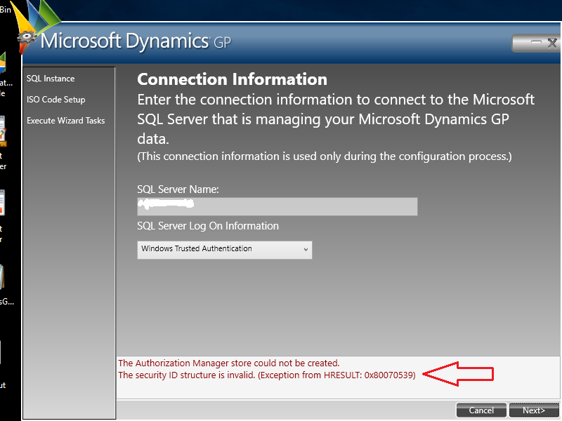

      Over the last few weeks I started seeing this error in my DEV, QA, & Staging environments. Restoring a SQL backup of the DynamicsGPSecurity Database solves it, but I would like to understand the root cause.
      If the database were truly Invalid, why does GP Web Services continue to work? Any Ideas?
      Tests

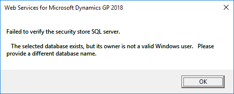

      • While opening theĀ GP Web Services Configuration Wizard (to add a new company), I have started seeing this error below.
      • Repairing the Web Services for Microsoft Dynamics GP 2018 fails with an error
      • Accessing the Dynamics Security or Exception Consoles both work ok
      • Stopping & Restarting the Microsoft Dynamics GP Service Host stops and starts ok. Does not fix the error

      October 14, 2019 at 1:18 PM
      Got it!
      It looks like my DB Team added some SQL users to the DynamicsGPSecurity database. I removed those users and I could use the GP Web Services Configuration Wizard without error.
      Reference
