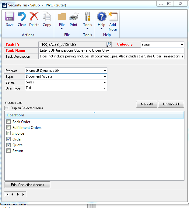

    • Thaddeus Suter
      October 25, 2017 at 8:48 AM
      Make the modified form(s) as they said hiding the costs and then control access to quotes and orders only like this for your sales people:
      Thaddeus Suter
      Retus, Inc
      TX
