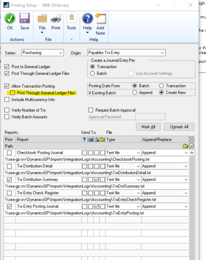

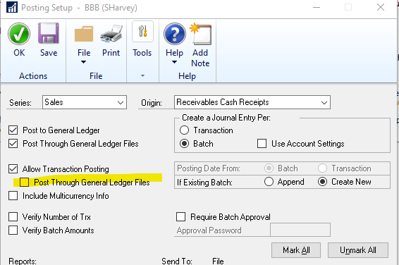

    I’m hoping someone here may understand how this relatively new field in GP works
    There is a field under ā€œAllow Transaction Postingā€ which is ā€œPost Through General Ledger Filesā€. This same field appears on this window twice (the other field with same description is two lines up). One is checked and the other isn’t. What is the difference between these two fields?
    We have transactions that don’t post through to GL from other modules. These end up in Master Posting and we must manually post in GL in the Financial module. I am wondering if this second field that’s unchecked could have something to do with it.

    The duplicate check box AFTER the “Allow Transaction Level Posting” is if you want GP to post through even if you are posting from a transaction instead of posting the batch.

    Just wanted to chime in on Jo’s comment.. there are still a few GP GL transactions that won’t auto-post with all the fields checked on all of the available posting setup: Intercompany, some Inventory Cost changes (especially cost changes from invoice match when the inventory is sold), and Manufactuing absorption entries. (Others – did I miss anything?) But checking that second box should help a lot if your users are not using batches.
    Hope that helps!
