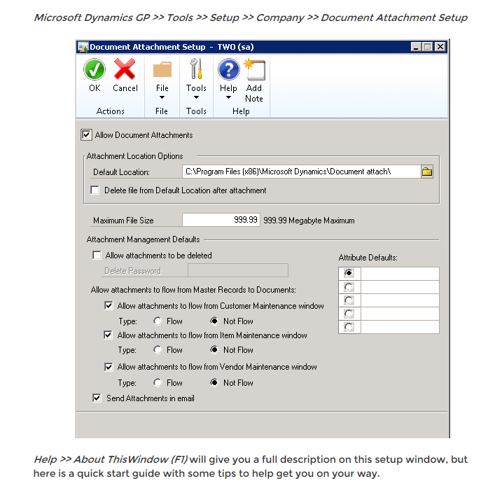

      ?If you are on GP2015 or later you could also look into enabling and using the “doc attach” feature.Ā  You would still follow the path provided in previous responses but after clicking on the paperclip, you would get the document attachment management window.

    • Angela Morehouse
      August 11, 2017 at 1:56 PM
      ?I’m sharing the notes I saved when I set it up in one of our companies:

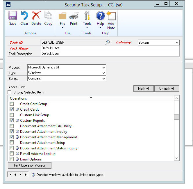

      And the 2 security settings (Document Attachment Inquiry and Document Attachment Management)
      Hope this helps.
