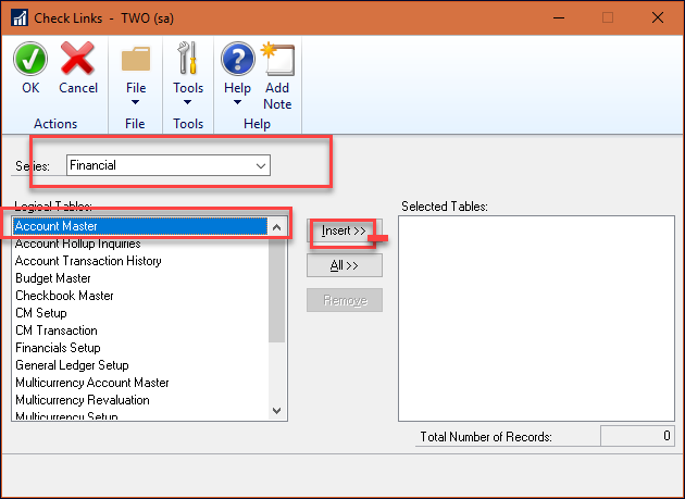

      This is usually caused by out-of-sync issues in your Account tables GL00100, GL00105, etc.
      The easiest fix is to get a backup of your database and run CheckLinks on just your Accounts.Ā  See screenshot below:
      I STRESS getting a backup.
