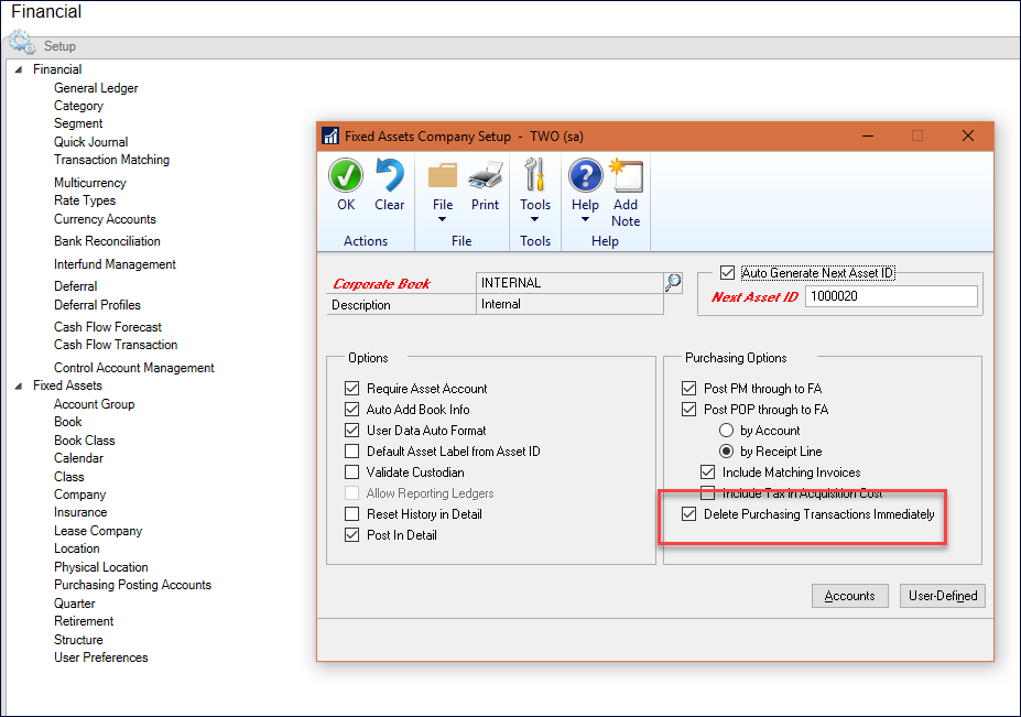

      ?Hi
      In Financial>Setup>Fixed Assets>Company do you have the below box checked?Ā  If not, this is the setting that will delete those purchases from that area once they have been entered as assets.

      Nothing more valuable to add rather than what’s illustrated above, this is controlled by the “Delete Purchasing Transactions” option on the fixed assets setup window.

      ?Hi Jo deRuiter,
      I checked our FA company setting and “Delete Purchasing Transactions Immediately” is marked.Ā  What else could it be?
