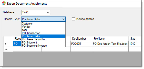

    • Steve Endow
      January 22, 2019 at 10:55 PM
      While only a partial solution for ‘s request,Ā I have updated my Save Doc Attach Files solution to add a SQL login dialog and a configuration file that allows you to add additional record types.
      Version 1.20:Ā  https://1drv.ms/u/s!Au567Fd0af9TpRUtDRq_heyOh50p
      (Version 1.20 fixes a bug that Zubin identified)
      Updated blog post:Ā Ā https://blog.steveendow.com/2018/12/bulk-export-dynamics-gp-document.html

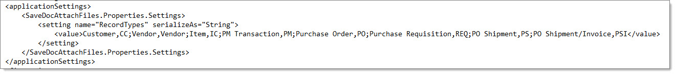

      Add additional record types in the configuration file:
      If anyone has the need to archive older attachments, I could look into adding a date filter and include the ability to remove the attachments from SQL to save space.
      And if anyone thinks of any way to add a pointer or link or note in Doc Attach that could point to a file share where the exported file is located, I could try to add that capability to remove the imported file and replace it with the pointer / reference.??
