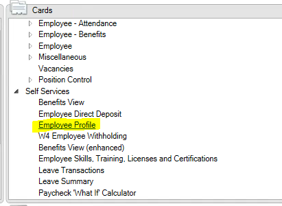

      If you are utilizing the self-service functionality, employees can be given access to view this information themselves by clicking the Employee Profile link.
      Self-Service menu
      You can also use SSRS to create a report that will return that information for the logged-in user

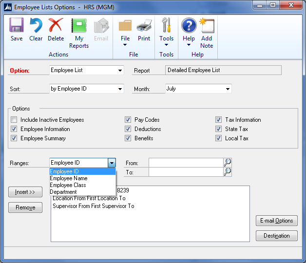

      Teresa,
      Take a look at “Detailed Employee List” and see if it fits your needs.
      Path:Ā  Payroll > Reports > Detailed Employee List
      You can specify one or all employees, or a range of employees, as well as selecting which information you would like to appear on the report. The “list” will print one employee per page.

    • Maureen Martin
      July 2, 2018 at 3:50 PM
      Forgot to show the screen shot:
