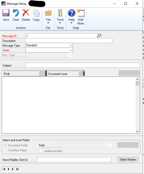

      Along with Jo’s reply, if you want it in the body of the email, Under Administration, go to Email Message Setup.Ā  This is where you can create templates for your email messages.Ā  You then set one of these default, and can change the message for certain customers (or vendors as this works for Purchasing and many other emails; statements, orders, remits, etc).Ā  Based on the fact that you are already emailing statements (assuming you are emailing directly from GP, you should have a message setup.Ā  So you can go find it and edit it.Ā  Then once saved, the next emails going out will have the changes you made.

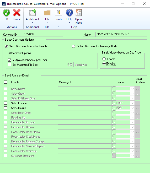

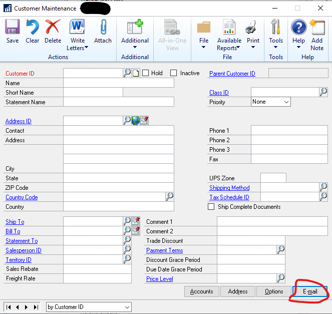

      To view what is setup, close both of these windows.Ā  Go into a customer card.Ā  In the bottom right click E-mail.Ā  This will bring up the window to setup your email messages.Ā  You will want to make sure the forms are enabled for what you want to send.Ā  Clicking the hour glass will bring up choices for email message templates to choose from.Ā  If you do not have any that match the type of form (sales vs purchasing), you can click New and create your template (my previous screen shot).Ā  Then go back to the customer and make sure it is in the line with the format (most likely PDF).Ā  Then if you have the option at the top enabled (Email Address based on Doc Type), then the ellipses on that form line will allow you to choose what email address to send this form to.

      Ok, that makes sense.   So I would like to put the body on all my emails statements.
      When I click on this particular customer, customer statement is greyed out.

      So it is disabled because you do not have a message template setup for that form (Customer Statement).Ā  If you close that window, in the Sales area, under Setup,Ā  Look for E-mail Settings.
      Click that.
      Check the box next to Customer Statement, and then you can click the spy glass to get tot he Message Setup window.
      Click New in the upper right corner.
      Create an ID, description, and then in Series and Doc Type Choose Sales and Customer Statement.
      Enter your subject, body and reply to information.
      Click Save
      Then back at the E-mail setup window, click the spy glass again, and choose your newly created message.Ā  This will set that as the default message for anyone getting these emails.
      Then you should be able to get back to your Customer card and check that box for Customer Statement and have your message id show in there.
