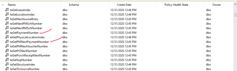

      First you look in SQL and see if the taGetPMNextPaymentNumber exists and it does. That is the screenshot I attached above.

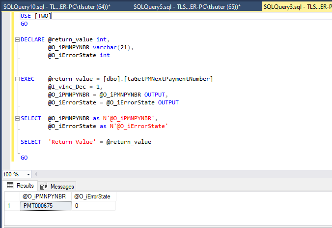

      Then you execute the procedureĀ  to see if it works or is buggy. See that it returns the next payment value of PMT00675
      Next screenshot:

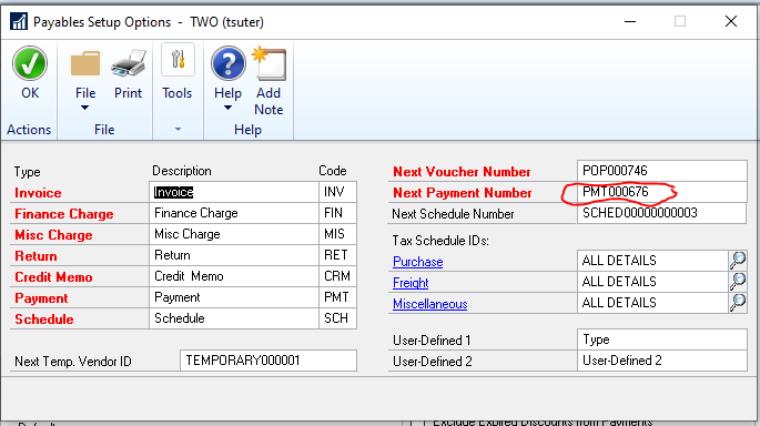

      Lastly compare that value to the value in your Payables Setup Options for next Payment Number and verify that the value increments by the input value ofĀ  vInc_Dec such as 1 that you provided.

      To complete the thought process here, what may be confusing for some developers is that when using taGetPMNextPaymentNumber, you must provide the value to increment the counter else the stored procedure will error and return error code 3393.
      To get around this modify the taGetPMNextPaymentNumber as follows by setting the value of vInc_Dec = 1 instead of NULL.
      Now you do not need to provide the input for vInc_Dec as I did above.
      Here is the modified ta stored procedure see BOLD.
