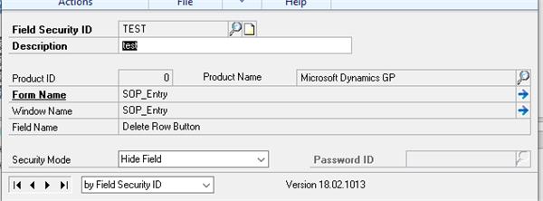

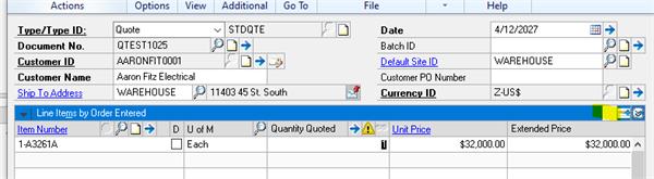

      1.)Hide the Delete Row field in the blue ribbon.Ā  I had some problems getting it to work with just password warnings or disabling/locking the field (but that could just be me).

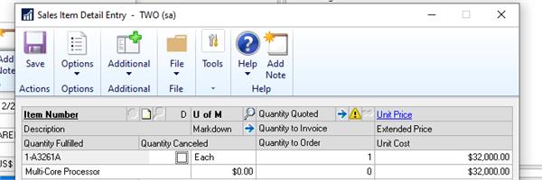

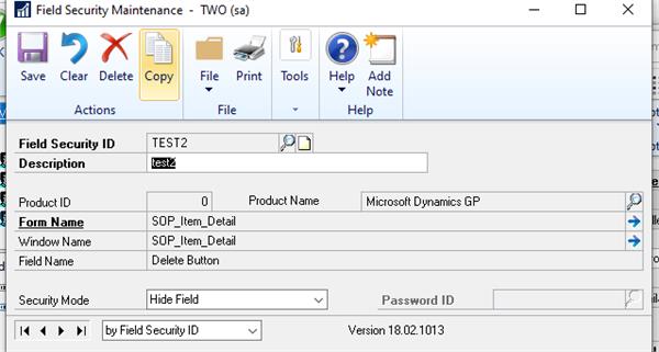

      2.) Hide the Delete Button on the Sales Item Detail Entry window.Ā  Again, some issues with the usage of passwords/disabling the field, but could be a “me” issue.
