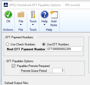

    • Richard Ward
      October 12, 2017 at 11:25 AM
      Tracy,
      The only setting for requiring EFT prenotes that I know of is on the Checkbook EFT Payables Options window.
      To get there, use:
      Cards-Financial-Checkbook
      Select your checkbook, then select EFT Bank button in lower right corner
      From the Checkbook EFT Bank Maintenance window, select Payables Options.
      I’m curious…did you “copy” and existing Vendor record somehow to create the new one, or was the new one set up completely from scratch?

    • Tracy Yaklyvich, MBA
      October 13, 2017 at 8:36 AM
      ?Richard, we do have prenote required checked.Ā  Thanks for telling me about that.Ā  I did not even know that was there!Ā  I am told the vendor set up was from scratch.Ā  How do you “copy” a vendor set up?Ā
