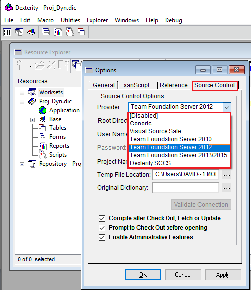

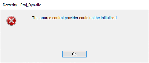

      I must be missing a step of two somewhere, but my attempts to select Visual Source Safe, or any of the three versions of Team Foundation Server just get me this.
      Does anyone have Dexterity Source Control working with Azure DevOps, and able to use these controls?
      What steps am I missing?

      Which provider did you want to use?
      You can install Visual Source Safe or TFS locally or use cloud based TFS.
      If just needing to upgrade, you can use the generic provider too.

      In order to connect Dexterity Source Code control to TFS or Azure DevOps, you must use the Visual Studio 2012 provider. Is the only one that can be used with versions of Dexterity ranging from 12 (GP 2013) to 18 (GP 2018 and GP modern lifecycle). Also, it’s the only stable provider among all the Visual Studio ones – personally, I have only gotten the Visual Studio 2013 provider to work once, and the Visual Studio 2015 provider has had a bug every since it shipped and it’s never been fixed.
      With that said, you will need to have Visual Studio 2012 with Update 5 installed. Older versions of Visual studio can be downloaded from:
      Older versions of Visual Studio page –Ā https://visualstudio.microsoft.com/vs/older-downloads/
      Visual Studio 2012 Update 5 package –Ā https://support.microsoft.com/en-us/help/3072098/visual-studio-2012-update-5

      I was so close. It is connecting now.Ā
