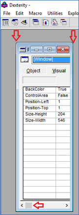

      Can anyone tell me how to correct a Dexterity annoyance? We are on GP 2018 R2.
      My Properties windows cannot be resized wider and are way too narrow. Clicking it seems to make it worse!

      Open the DEX.DIC
      Add a button on the “Properties” window of form “Window Layout” with a call to ” Window_SetBaseSize() “

      Hi David
      I wrote this as a blog as I have seen it many times.
      https://winthropdc.wordpress.com/2020/06/04/dexterity-fixing-the-properties-window-width/
      Regards
      David
      PS: Hope you don’t mind me using your screenshot.
