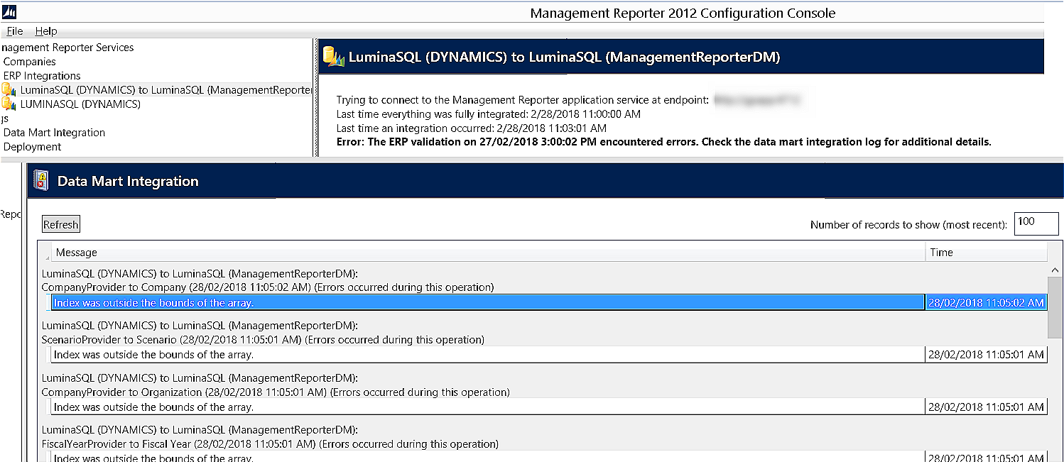

      In Management Reporter configuration console DYNAMICS to ManagementReporterDM integration has a warning:
      ‘The ERP validation on 27/02/2018 3:00:02 PM encountered errors. Check the data mart integration log for additional details.’
      The integration logs have a lot of errors the main constant being ‘Index was outside the bounds of the array.’

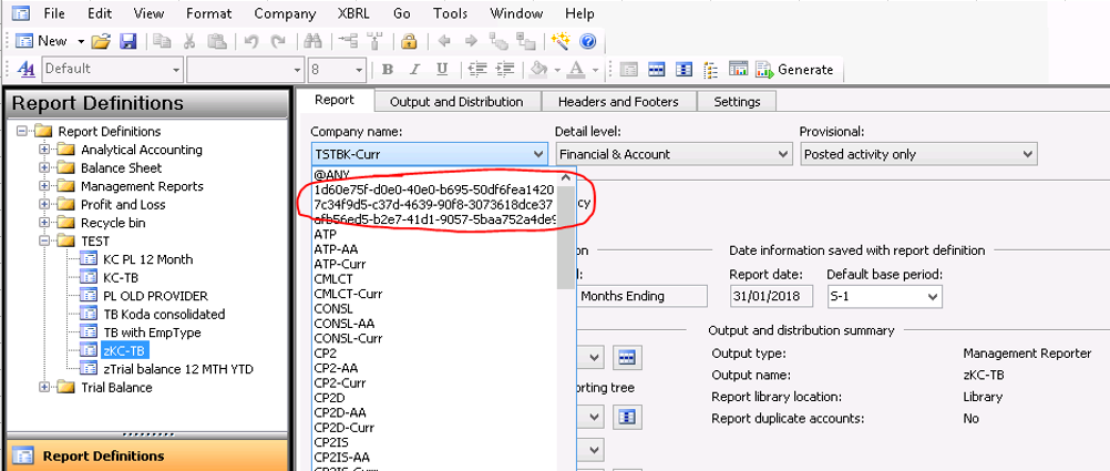

      1. Determined that Legacy reports were in fact correct and Datamart incorrect.
      2. Took a backup of the related database and restored that backup to a Test Database.
      3. Run reconcile GL (Tools > Utilities> Financial > Reconcile) from oldest year to current open year.
      4. Found strange/orphan records in MR as per below. Verified that these records pertain to databases which no longer exist. Cleaned up this data in MR.Ā
