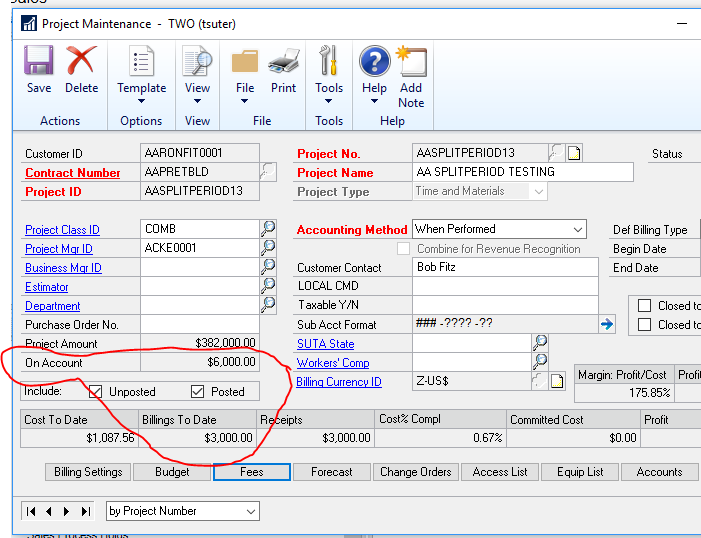

      To support multiple Invoices against one prepayment, both SOP and SVC CA would require a Cash Receipt posted to Prepaids and then Applied to each Invoice after posting. You would probably use Customer Statements to show the Prepayment, what Invoices it is applied to and how much is left.
      In PA, prepayments (called Retainer Fees) is fully supported and shows as On Account on the Project. Each Billing may or may not have the Retainer applied before Posting, until the On Account Retainer goes to $0.00.
      One thing to know, the PA Project Customer must actually Pay the Retainer Bill. You cannot apply the Retainer Bill to subsequent PA Invoices. You can only apply the Retainer Payment to subsequent PA Invoices . So if they don’t actually pay the Retainer, don’t do it.

      The other issue you would have with the retainer would be that you would have to do all of your billing from the Project Accounting module.Ā  This could work and is very useful, but it may take more work.

      We’ll give the PA approach a shot.Ā  My preference was to keep the billing all in one place (currently done in SOP) as we have the same clerk/groups handling both non-prepayment and prepayment activity BUT we’ll take a further look and see if we can make it work.
