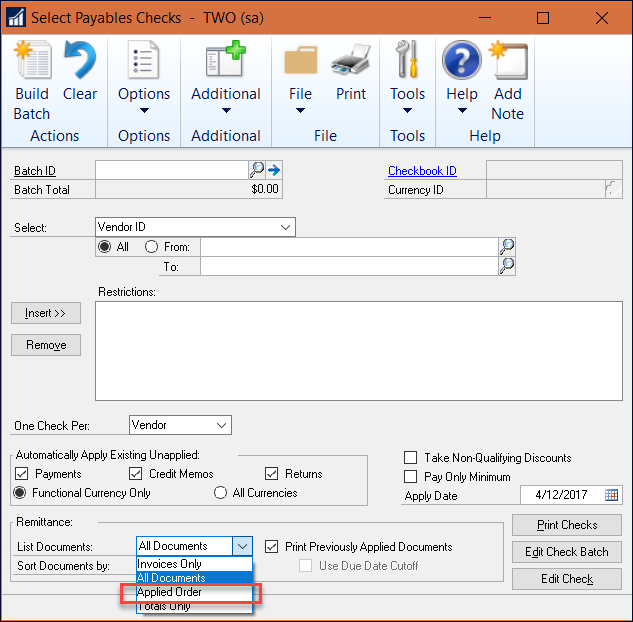

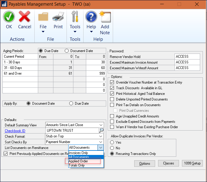

      Just to confirm, in A/P Setup you have this drop down selected as “Applied Order”?
      And, during Select Checks/Payments you also have it as Applied Order?

      Yes both boxes have Applied order selected .
