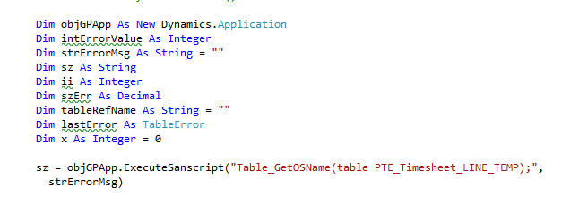

      ?Is there a way to capture what SQL temp table is being used on a particular Dynamics GP window through the use of VS tools?Ā  I found some examples of capturing table buffers but I can’t figure out how to capture the actual name of the temp table in SQL so that I may be able to query the data.
      Update:
      Is there a way to capture the string when you execute the Table_GetOSName function?Ā  The ExecuteSanScript function only returns an integer indicating if the script ran successfully.Ā  I was trying to run the Table_GetOSName function to return the SQL temp table name it using.Ā  For example…Ā  ##213578

      Hi Greg
      That will not work. When you execute() code it runs as a global procedure in the target dictionary.
      As a global procedure it will create a new instance of the temp table which will be empty.
      You might be able to get it to work using the default form to {form name}; command as the first executable line in the script to change context. This sometimes works to get the form’s instance of the table buffer.
      Also to use parameters you will need to mark the add-in as COM visible on the assembly version property window.
      Does that help?
