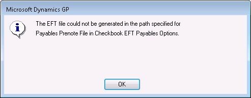

      Just last week we started having a problem with saving our EFT file to the network. Ā Below is the error we get. Ā Before last week we never had an issue with saving the file.
      IkXOgf5ESiCV6LSoHlpG_eft-nosave.jpgThe path is correct. Ā What is weird is our Safe Pay file saves to the same location and that works fine. Ā We also can’t save any reports to the network mapped drives. Ā This is the error we get when we try and save reports.

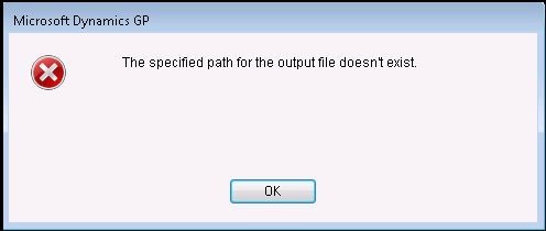

      xzWZ3sssTSmx36urOfrY_report-nosave.jpgWhen we get this error it does save a file with a size of 0. Ā I have found if I try and run a report and have it save to the network and I choose ‘append’, that I first get this error then if I run the report again, it will save. Ā It won’t save if I choose ‘replace’. Ā This just started happening last week. Ā From what I am seeing online it isn’t a GP issue but an issue with the network. Ā I am trying to get our tech support to look into this but they insist it is a GP issue. We don’t use a terminal server and have GP installed locally on everyone’s computer. Ā This is happening for all users. Ā We are on GP 2015 R2. Ā We can save files to the C drive but can’t save to the network mapped drives. Ā Anyone seen this before and know what the fix is? Ā Ā

      Definitely sounds like an internal network issue. I always findĀ approaching IT and asking what has changed in the past week, then go from there.

      Can you save locally?
      Can you save to the network drive from Excel or word or other apps?
      Does the network drive map as a drive letter or the UNC path (\servernamesharepath)?
      Try manually mapping a network drive with the drive letter Z or something not used and see if you can save to that.Ā Ā Ā Ā
      GP used to have a problem saving to the UNC names but havent’ tried that in awhile.
      LMK the answer to the questions above and I can probably help solve the issue.

      We can save to the C drive. Ā Can save to the mapped network drives from Excel, Word, everything else. Ā Did try and change it to save to a UNC path instead of the mapped drive and still didn’t work. Ā We had someone do some changes to the network on the evening of the 16th and the morning of the 17th we started having the problem with saving files. Ā The person swears what they changed would not cause this issue. Ā Going to have to corner this person and make them look into this since we have ruled out everything else that might be causing it.

      Well, it took almost 2 months to get this fixed but wanted to let everyone know in case this happens to someone else what ended up being the issue. Ā It ended up being an issue with the antivirus on the server where we were trying to save reports. Ā We tested this by turning off antivirus on the server and we were able to save reports. Ā So, when we found that out, our internal tech support made a change with the antivirus software so that it was still running but we could still save reports. Ā I don’t know what was changed (they won’t tell me) but thought this piece of info would help someone else out if they ever ran into this.
