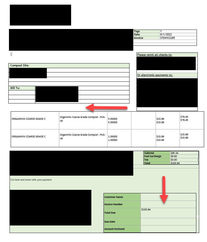

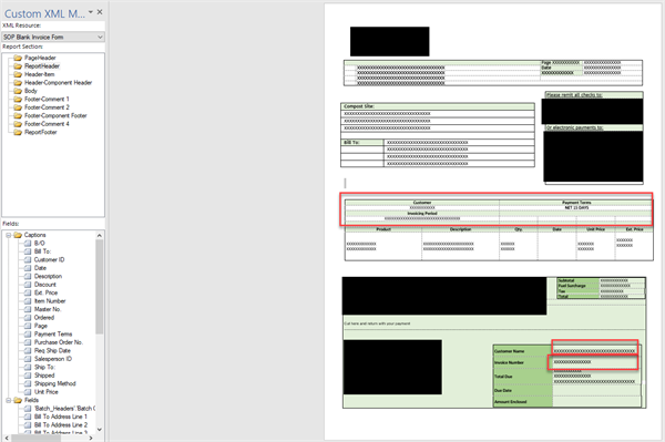

      However with that, our end users gave some recommendations to fix up the old template. I am coming to the following issue: I cannot print out certain fields from Great Plains to our custom invoice. The fields are mapped properly with XML formatting (via ‘TemplateGenerator’ in the Great Plains Installer)
      This leads me to my question: is there a limit to how many fields you can map from Great Plains Report Writer? I have provided screenshots for what our custom template looks like, to what it shows afterwards. The print ends up deleting certain parts of the template, which was largely generated by Great Plains. The fields next to Invoice Number are being reused, so I am unsure as to why one of the fields will print, but the exact same field will not if I use it later in the template. I have also differentiated between Report and Page Headers when troubleshooting.
      (I have blacked out sensitive information for privacy concerns)
      How the template is set up (prior to invoice print)
      before
      Arrow show fields that are not mapping/how the template is altered after the invoice is printed from Great Plains
      after
      As far as I know there is no such limit for the number of fields exists. Further your report doesn’t have that many field as shown in screen shot.
      You said you have custom template, I want to know which Dynamics GP report you use to create this template? is the original report modified?
      After creating initial template did you modify the original report ?Ā
      Also read below from troubleshooting word template issues.
      Field values are empty
      If a field value is empty in the generated Microsoft Word document, check the
      following:
      • Verify the item was dragged to the report template document from the
      appropriate report section of the XML data. If the item comes from the wrong
      section, it will not contain any data.
      • Be sure that you have all of the tables needed for the report template document.
      Data values may not appear in a report if the report is missing one of the
      standard tables, such as the Report Header table.
      Items missing from Custom XML
      If items are missing from the Custom XML for a report template document, this
      typically means that the report definition was changed after the report template
      document had been generated

      Angela,
      After you generated the XML file from the modified GP report, did you remove the existing XML definition from the Word Template before adding the new XMLĀ  def back ? That’s the only way you’ll be able to see any newly added field in RW… (or by the matter, any field format changes or calculated field changes).
