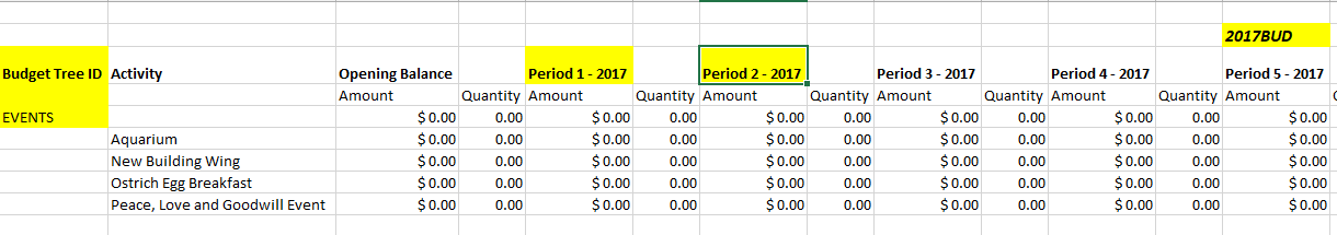

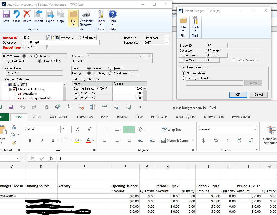

      You should be able to export the budget from AA as well.Ā  In your AA Budget Card – click Export in the menu and you’ll get that second screen shot asking where to send it to.Ā  Then an Excel spreadsheet will open that has the format you need.Ā  Then you can just change the applicable fields and re-import.

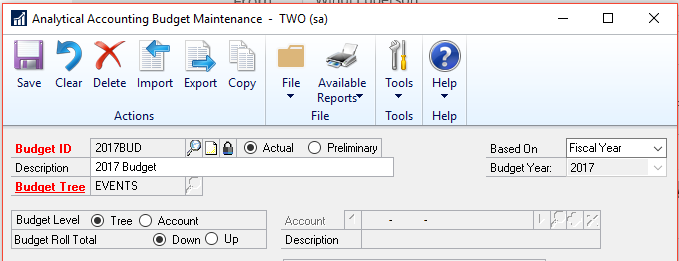

      I haven’t found anything yet on the currency, but you can only import a budget if the budget ID, budget tree ID and budget year match the values in the AA Budget Maint Window.Ā  I’ve highlighted those below so you can see where they show compared to what I have in my setup.Ā  See if maybe that points you in the right direction and I”ll dig into the m/c a bit.

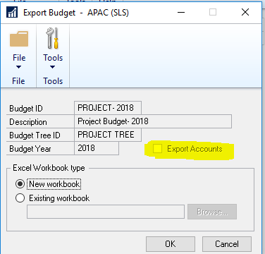

      In the previous set of screen shots, you’ll see that mine is grayed out too – but that’s because on the AA Budget Maint window I have it set to budget by Tree.Ā  If you want acct level budgeting, you’ll need to toggle that switch.Ā  It’s right below the budget id.

      This has been a good learning experience for me. We do budget on the account level and our system administrator is working on granting access to the Export Account check box.
