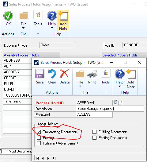

      There is a USER2ENT and Create Date on each Invoice so that usually means the person who transferred it from an Order. You can also use SOP Process Holds on Transfer and have the Hold assigned to the Doc Types. Of course someone could remove the Transfer Hold and then not actually Transfer the Doc, but their Name(userid) and Timestamp would be on it.
