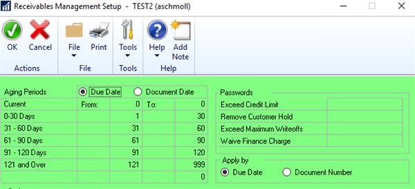

      I changed our AR aging buckets under Sales/Setup/Receivables to add a bucket for 121 and over days. I’m looking for a Historical Aged Trial Balance report that will export to excel and will show the new bucket. I don’t want to customize any reports but was looking for one that would incorporate this change. Can you please point me to the right area? I did find one under Sales/Reporting Services Reports but I wasn’t able to get any data to show up so I’m not sure if I’m doing something wrong. Thanks!

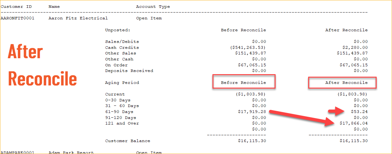

      October 6, 2020 at 11:06 AM
      As usual, your best bet is SmartLists.
      Once you change your Aging periods, be sure to run a Reconcile in AR so that GP moves the transactions to the right buckets for reporting.Ā  THIS STEP IS OF VITAL IMPORTANCE

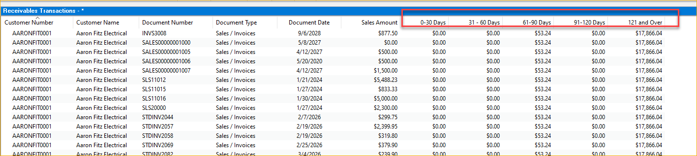

      Then, in SmartLists (not builder, just straight SmartLists) your new buckets will automatically show up to add to reports.Ā
      Shoot those into Excel and Pivot on them for excellent reporting.
      here are some screenshots:
      And Now, without any customs or alterations other than just adding the columns I have this:
      This was done on my test system in just about 3 minutes.
