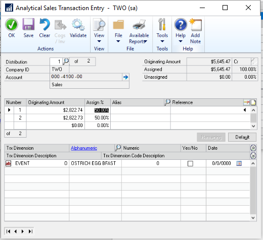

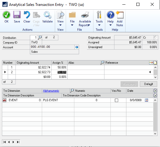

      HeyĀ
      I’ve been wanted to reach out on this for about a week, but I blew up my test company and just had time to rebuild it. šŸ™‚

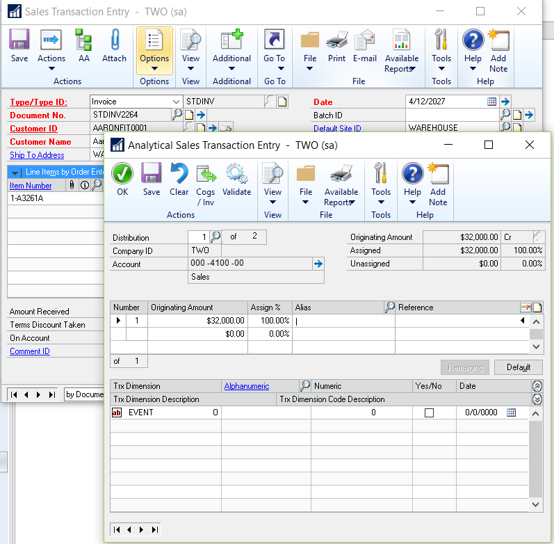

      The thing that caught my attention was only being able to code to one AA code on a Sales Transaction.Ā  You should be able to code to multiple codes.Ā  On the main Sales Trx Entry window, if you go to AdditionalAnalytical Transactions, are you not able to change the percentage in the top half of the screen?Ā  In my shots below, you’ll notice I have 2 lines in the top 1/2 at 50% each.Ā  Clicking each of the 2 lines, shows a different code in the bottom half.Ā  So I’m distributing to the same Trx Dim, but to 2 different Trx Codes.Ā  Does your system not allow this to happen?

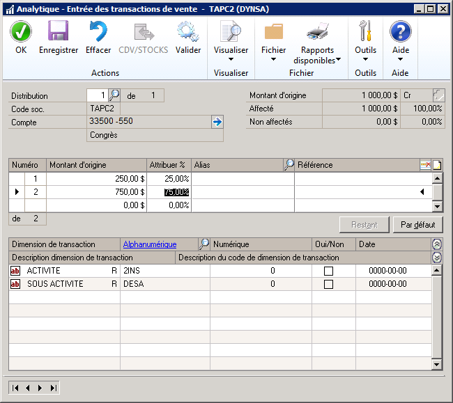

      ?Good evening Shari
      We often wonder if we are the only ones using AA in such a detailed manner. Well, now I know I am not alone
      We use AA in our sales invoices and we can attribute the amounts affected per GL account, to different variations of AA codifications.
      However this is done per GL account on the general SOP page and not per item line.
      We do it once all our items are entered and access it either from the distribution button or the top menu leading to AA transaction
      This approach creates no problem whatsoever with our Financial statements
      Hope it helps
      PS
      We use GP 2016 ( before 2010 R2) in French, but you should be able to replicate easily

    • Shari Bruno
      January 12, 2018 at 9:51 AM
      ? and

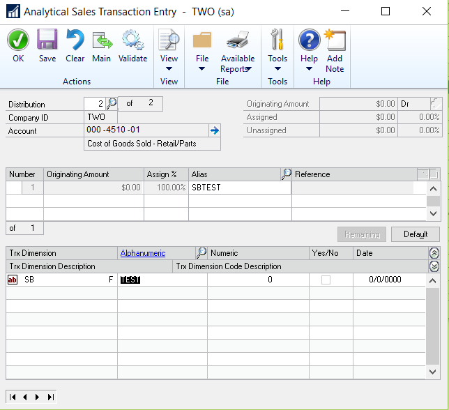

      Thanks so much for your input!?? What the two of you can do thatĀ we cannot is assign a percentage other than 100 to one AA code, and the remainder, or remainders, to another on the sales invoice. The section of our Analytical Sales Transaction Entry windowĀ with the originating amount is grayed out. All we can do in that window is assign the AA codes.
      Something else on your windows that is not on ours is that yourĀ Originating Amount is populated with a dollar amount – ours records $0. This is due to the FIFO layering of our inventory. Until the sales invoice is posted the exact value of the inventory is not known. Microsoft was on a GoTo meeting with us at the beginning of the month viewing our screens as we went through the process and they did not comment on the $0 value which makesĀ me think this is not a problem. Still, I am curious as to why both of you have a value, and if this value changes once the Sales Order is posted and the inventory is removed.
      Microsoft is looking into this but a fix may not be available until the next GP update. OnĀ our end we have found thatĀ there is not an issue with the net income on the Balance Sheet flowing properly to the Income Statement unless the Originating Debit/Credit columns are being accessed, which would happen in our companies where USD is not their functional currency. So I am monitoring the reports anytime the Edit Analysis window is accessed for any reason, in any of our companies, to see if we can isolate the issue.
      I would appreciate any additional insight thatĀ the two of you have on this issue.

      This may explain why you get a dollar value in your Originating Amount, a service item would not have FIFO layering.
      Is this true for the items that you assign AA codes to as well???

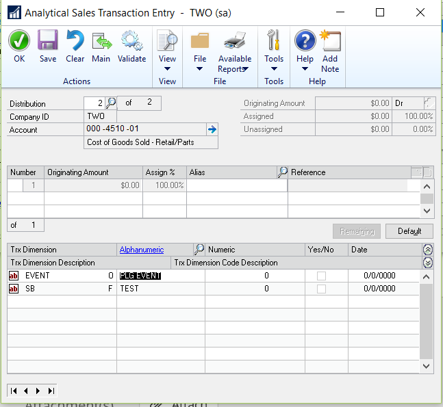

    • Windi Epperson
      January 12, 2018 at 3:09 PM
      @Shari Bruno
      Looks like you’re on the right track with inventory items.Ā  I can change the originating amt for the sales distribution, but not for the COGS distribution.
      Help says:Ā
      In an invoice, you can enter analysis information for the Cost of Goods Sold (COGS) and Inventory accounts of the relevant item numbers entered in the invoice, if such accounts are linked to an account class even though these accounts are not displayed in the Sales Distribution Entry window. However, you cannot create assignments for such accounts as the amount that updates these accounts can be determined only after the invoice is posted.
      But, I was able to fool it a bit – just not sure if this option would work in the real world.Ā  In the AA Acct Class setup, I set 2 different dimensions to be optional for the class.Ā  Once I did this, both dimensions were available to code to in the AA coding window. Ā
      Not sure if it’s feasible for you to setup 2 dimensions that track the same thing but thought I’d show the option.

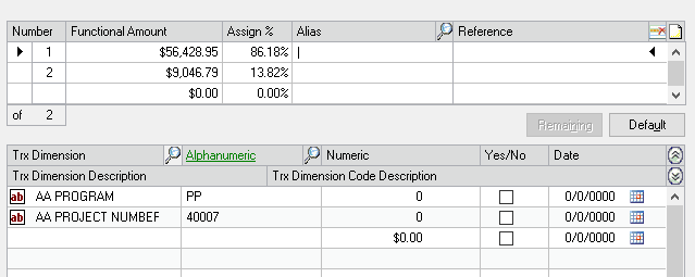

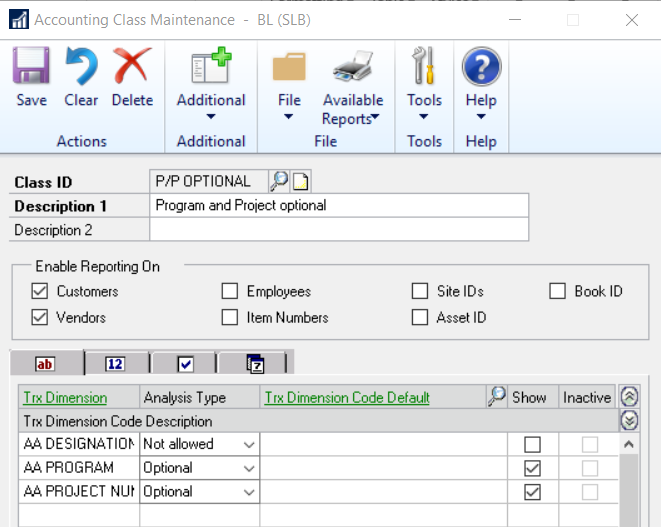

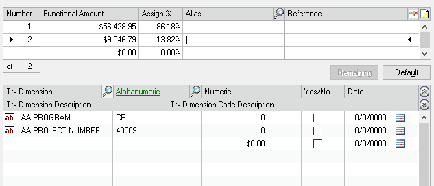

      We already have two dimensions that are optional for the same class as we track two different items in AA – Programs and Projects,which are each connected to another – every Program has a Project.
      At times we don’t need to split beyond 100% and in that case the AA coding can be added on the sales invoice. But when we do split the percentages are not even numbers, as seen below, because they are based on the number of items that are being used for a particular program-project, and not a specific dollar amount.
      So maybe we are using AA in a way that most people don’t. Wouldn’t surprise me actually. We haveĀ  a lot of unique reporting needsĀ that I had notĀ encountered in the Finance positions I held before I came here.
