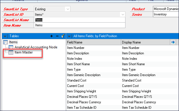

      You are right, that is not anywhere in the Inventory Smartlists at all.Ā Ā  The field name is “Inactive”.Ā Ā
      The only way I got it to show was a custom Smartlist (Designer or Builder) looking at the Item Master and joining with the default Smartlist (SL Builder) on the Inventory Number.

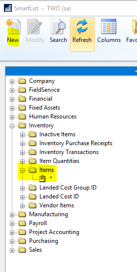

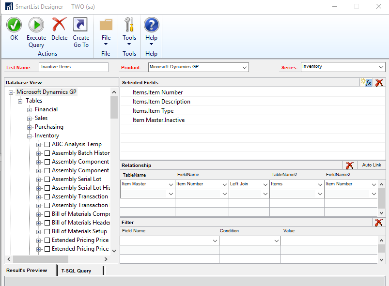

      Highlight the Items folder then click New.Ā  Navigate to Microsoft Dynamics GP > Tables > Inventory > Item Master > Inactive (check this to bring it into the selected fields area).Ā  Then create the relationship between the two tables as shown below in the screen shot.Ā  Execute Query to verify it works then click OK to save this as a new SmartList.
