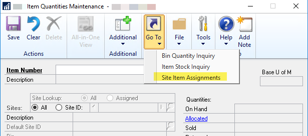

The way I understand it, the item will not be available to add to the SO from a location different than where it was received on the PO, until you do an inventory transfer from the PO site to the SO site.
To allow the new inventory item to be used at all the sites, you must assign the item to all the sites on the Site Item Assignments screen (accessed from the Go To menu on the Item Quantities Maintenance screen).
Please note:
