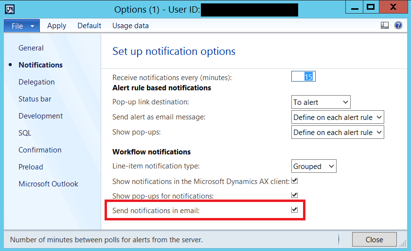

    • Rick Pierson
      August 8, 2018 at 11:12 AM
      EDIT: Late to show and less information than the others.Ā  But I cannot delete this.
      Hi Nazim.
      You did not give much information (is it not working for anyone? for a single user? what version of AX/365?), but in AX 2012 R3, you need to make sure that a user is setup to receive notifications via email.
      User Options: Email Notification

    • Najeem JanatAli
      August 8, 2018 at 6:10 PM
      Hi Rick
      Its AX 2012, R3
      email is set up as well as check mark for notification
      PR workflow email notifications are working. However PO email notifications are not wroking
