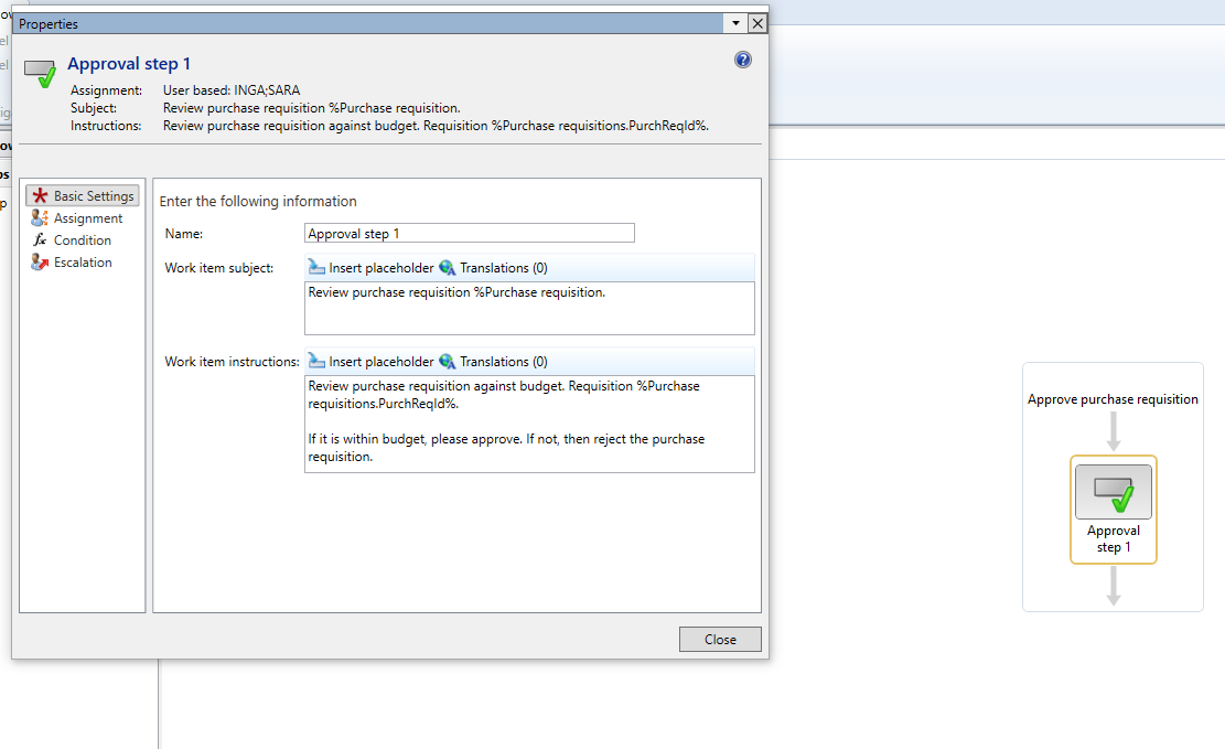

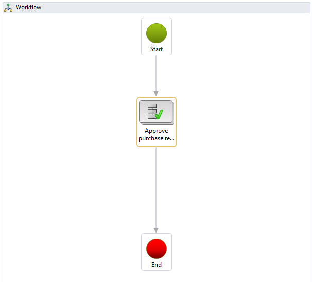

      You can use the Purchase requisition workflow in Procurement and sourcing > Setup > Procurement and sourcing workflows > Purchase requisition review.Ā
      It can be a pretty simple workflow, like as seen below:
      Since you are just sending it out for approval, you don’t even need to have dependencies in the system for it, just that it exists.Ā
      Create the dialog in basic settings to alert your approvers that they have to approve or reject based upon criteria specified.Ā
      Basic dialog in workflow stating that user must review purchase req against budget manually.
      Your approver will see this when they review the workflow on the Purchase requisition:
      Purchase requisition review - user will see approve and reject buttons with instructions from prior example.

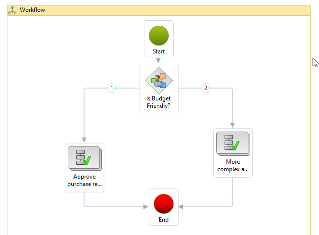

      You can add a manual decision as the first step of your workflow. Yes or No would have to be decided by the workflow designee. From there, you can build additional workflows off each branch.Ā
      more complex workflow with manual decision

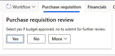

      When the workflow gets assigned, the manual decision will be made and then kick off the next workflow based on decision made (Yes or No in my example).Ā
      Budget yes or no manual decision
      In my example, I selected No, which kicked off my more complex workflow. This sent a workflow to the workflow designee to Approve or Reject the purchase requisition.
