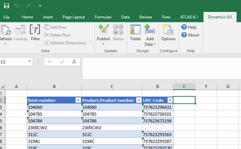

      I am trying to update a custom field in the InventTable in AX 2012 R2 CU6 using the Excel Add In and I am getting the following error message.Ā
      Cannot create a record in Items – storage dimension groups (EcoResStorageDimensionGroupItem). Item number: 2300CW2, ST-WH-LOC. The record already exists. Document Generic document could not be updated. Error details: Cannot create a record in Items – storage dimension groups (EcoResStorageDimensionGroupItem). Item number: 2300CW2, ST-WH-LOC. The record already exists.
      The process I used was – Add Data -> Add Tables -> InventTable.Ā  The item number and product.product number fields are mandatory, then IĀ added the UPC Code (our custom field).Ā  I clicked refresh to retrieve the values in AX.Ā  ThenĀ I updated the UPC Codes for the ones that were missing and clicked publish.
      HasĀ anyone else run into this?Ā  I am not trying to create anĀ item,Ā just update it.Ā  Any suggestions?
