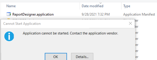

      Unable to create new report nor able to edit the existing default reports in Financial Reports. Any click creates Report Designer Application. Clicking Report Designer application error out with message “Application cannot start, contact application vendor”
      any one have came across with any error message using FR for the first time in D 365

      Use the Edge browser, it doesn’t work with Chrome.
      Financial reporter is a ‘one-click’ application.

      This creates a popup which may be an issue on your browser.Ā  The OneClick extension (For Chrome & Edge I use the Meta4 ClickOnce Launcher).

      • If you are using a Chrome browser, you must install a ClickOnce extension in order to download the Report Designer client. If you are running Chrome in incognito mode, make sure the ClickOnce extension is enabled for incognito mode. For more information about the Chrome ClickOnce Extension, seeĀ System requirements for cloud deployments.
      • If you are using Microsoft Edge with a Chrome browser, you do not need to install a ClickOnce extension for Edge Chromium. However, you must enable the ClickOnce option in order to download the Report Designer client. If you are running incognito mode, make sure the ClickOnce extension is enabled for incognito mode.
        1. Open a new browser in Microsoft Edge.
        2. EnterĀ edge://flagsĀ and selectĀ Enter.
        3. Search for theĀ ClickOnce SupportĀ option or use this direct link:Ā edge://flags/#edge-click-once.
        4. Set the drop-down menu option toĀ Enabled.
        5. SelectĀ Restart Browser.
