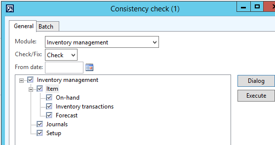

    • Glenn Linaa
      July 4, 2019 at 2:23 AM
      Hi Mark.
      It looks like a delivery schedule. Line 1 is 80 units. This has been split into 4 deliveries of 20 units.Ā
      Line 6 is the odd one. You have 20 remaining but there are no quantity in the column of either ordered, arrived or registered. That tells me that your transaction is not in balance with the order.
      Please try to run a consistency check on that particular item no. (system admin/periodic/database)
      Remember to use the dialog to limit the run to only this item number in order to save time.Ā

    • Mark Yankovich
      July 5, 2019 at 9:59 AM
      Appreciate all you responses as they have helped grow knowledge.
      Michael – there have been no modifications made around this process.
      To Glenn’s most recent post, I had not noticed “
      20 remaining but there are no quantity in the column of either ordered, arrived or registered”.Ā  This line was indeed out of balance.Ā  As a ‘work around’, this line was removed from the delivery schedule and a new line created.Ā  The registration form now appears as it should.
