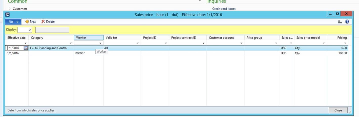

    • Gail Kruger
      October 8, 2018 at 4:50 PM
      I think the only way you are going to achieve this is if you set up that project category for every worker šŸ™ When you use an “All” option, that’s when the “Table” options will take preference. So you will need to use Table as below:
      Sales Price Setup
