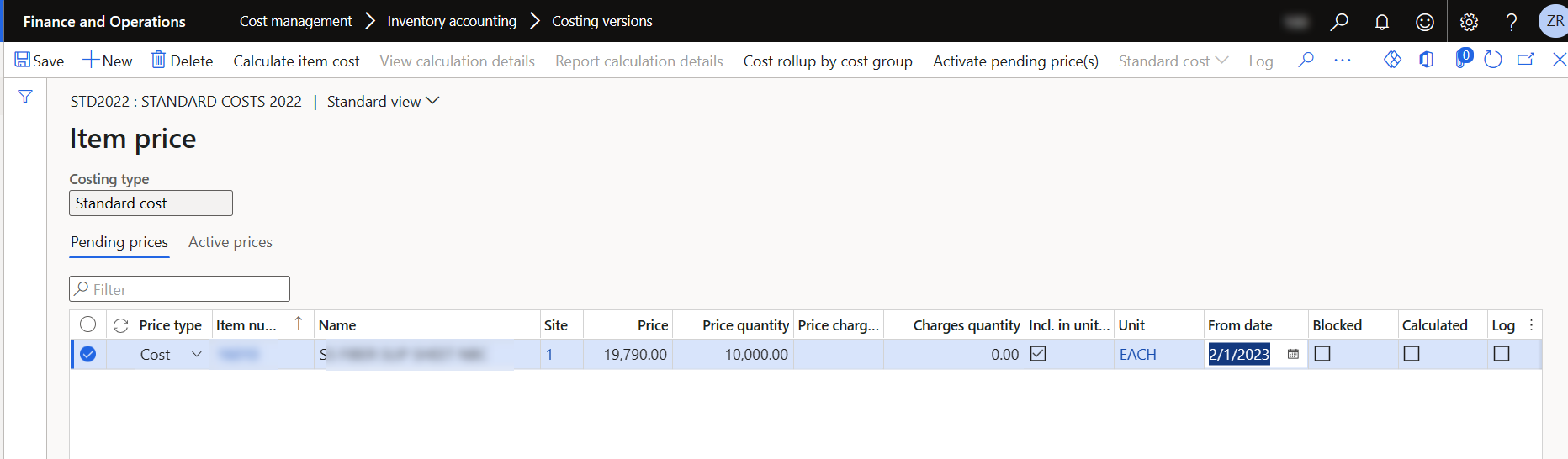

      We are looking to use STD cost Costing Method for our inventory.
      New STD cost values are calculated and take effect on the first of the month (say – February 1st)

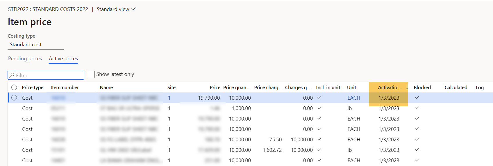

      On the Costing Versions form, I can set up new STD cost with “From Date” value of 2/1/2023
      but when I activate the cost, the Activation date (=the date from which the cost is effective) is set to today’s date.
      So how can I make sure my new STD cost becomes active on 2/1/2023, and not today?

      I looked at it further and realized that if I press the [Activate] button from the HEADER of the Costing Version (and not from the line level of products), I can actually schedule the activation to be scheduled as a batch.
