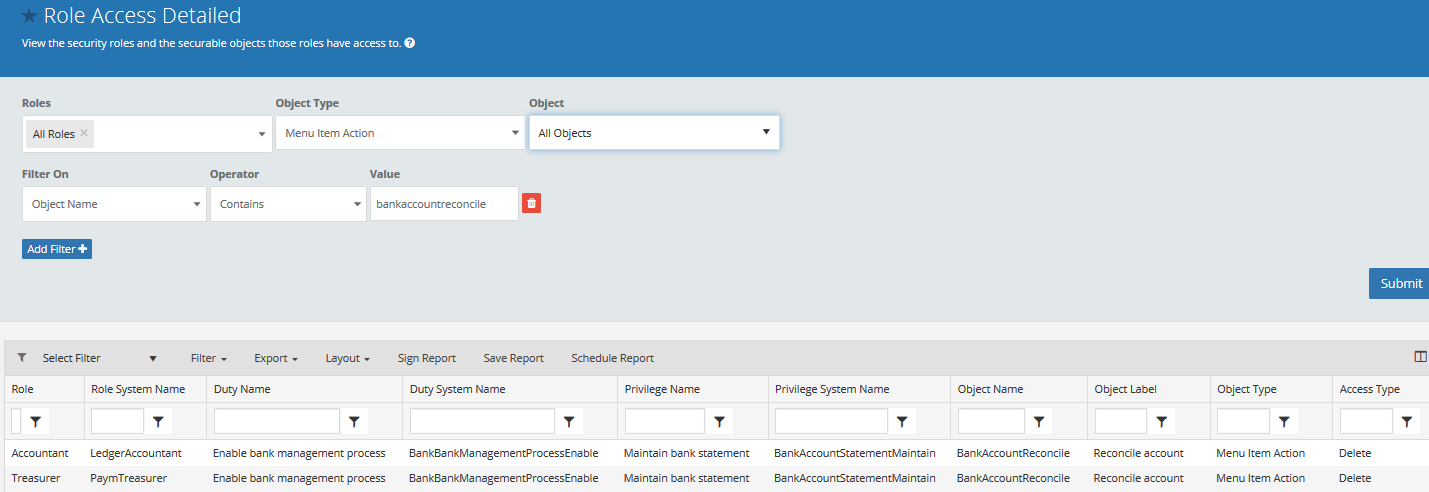

      I’m not sure what process you followed to see this menu item, normally you can right click on the object itself and get object information on it. But based off the name I was able to find a BankAccountReconcile menu item action object. This object appears on the BankReconciliation form tied to the BankReconciliation menu item display.
      It appears the BankAccountReconcile menu item action is assigned to the BankAccountStatementMaintain privilege, which is assigned to the Accountant and Treasurer roles.

      I created a new Privilege (Duplicate of Maintain Bank Statement) and on theĀ BankAccountReconcile menu item action i put the options on Deny instead of granted and it worked. The Role can no longer see or click the Reconcile button.
