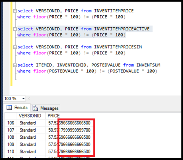

      Scripts to check for extended decimals.
      select VERSIONID, PRICE from INVENTITEMPRICE
      where floor(PRICE * 100) != (PRICE * 100)
      select VERSIONID, PRICE from INVENTITEMPRICEACTIVE
      select VERSIONID, PRICE from INVENTITEMPRICESIM
      select ITEMID, INVENTDIMID, POSTEDVALUE from INVENTSUM
      where floor(POSTEDVALUE * 100) != (POSTEDVALUE * 100)
