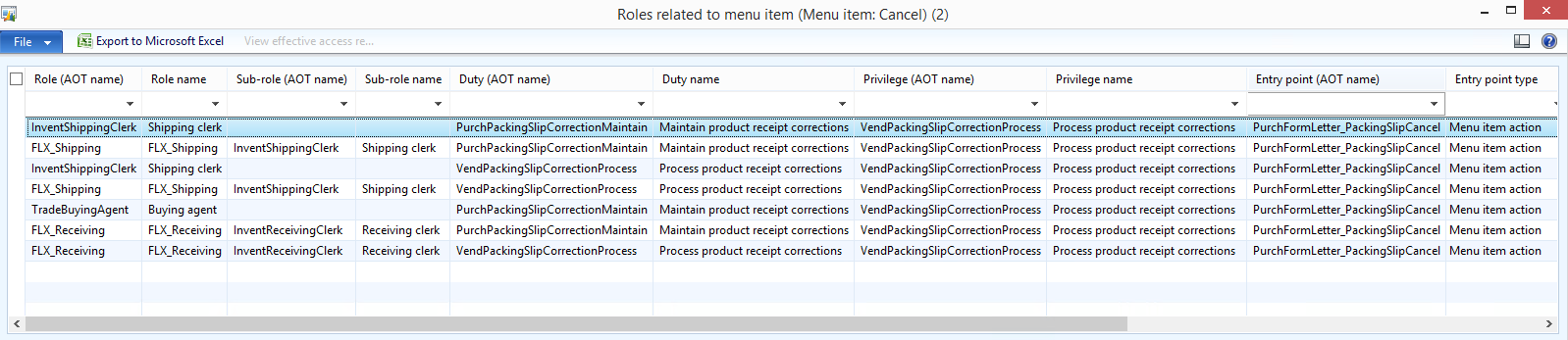

      We are on AX 2012 R2 and these are the roles/duties I would look at…
      Cancel PO Receipt

    • Ismail Nadir
      October 9, 2018 at 1:34 PM
      Receiving clerk can cancel this … but if your PO is related to the SO , you have to add Shipping clerk too…
