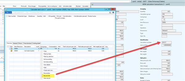

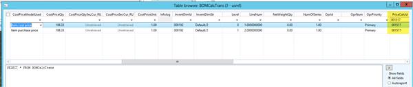

      If you look at BomCalcTrans and sort by your missing rates or by your item number, do you see the rates appearing in this table? You may need to sort by calculation number instead, screenshots below on how to identify this value on your active cost:

      Appreciate all your help.Ā  As mentioned in my first post, the BOM calculation is working fine in our Sandbox AX 2012 Environment (TR) but not working fine in our PROD AX 2012 Environment.Ā  I compared the RouteCostCategoryPrice and CostSheetCalculationFactor between TR and PROD and they are exactly the same.Ā  So I’m going to assume these are setup fine.Ā  In regards to the BOMCalcTrans, I have attached an extract of the file from our TR and PROD environments so you can see the difference in the two.
