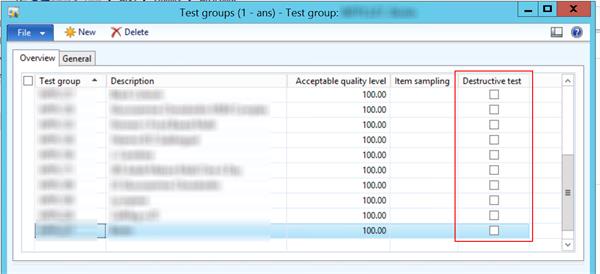

      The Destructive attribute is managed in the Test Groups list:
      Test Groups
