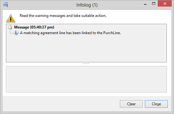

    We have recently migrated from AX2012 to D365, and we have noticed a difference between AX and D365 and I am hoping we have a configuration issue in D365 and not that the AX functionality doesn’t exist in D365.
    In AX, if you have a Purchase Agreement setup for item/vendor for a specified time frame, from 1/1/2023 to 3/31/2023. You then firm a planned purchase order to deliver outside of the validity period, the purchase order is not linked to the PO. However, if you change the PO delivery date within the validity period, an Infolog appears “A matching agreement line has been linked to the PurchLine.”
    In D365, it appears we have the exact configuration as AX2012, however, when we perform the same operation as stated above, we don’t receive the Infolog as in AX2012.
    Your help would be appreciated.

    Hi Erick, my guess is that this is something that was designed custom for your environment. We typically don’t see the table name (i.e. PurchLine) in standard infologs. I did some testing in D365, and while the system does attach Planned orders to the appropriate Purchase agreement, it does so without any fanfare or messaging. Should it? Perhaps! But that’s a different conversation. šŸ˜„
