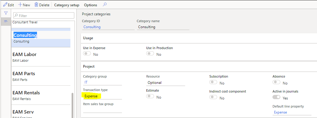

      I guess the issue I am running up against is the Project Category I am using on the Purchase Agreement seems to need to be set up for “Item” transactions, and we use Project Categories that are “Expense”.
      So, for example, I have a project that uses Project Category Hardware, which is set up as follows:

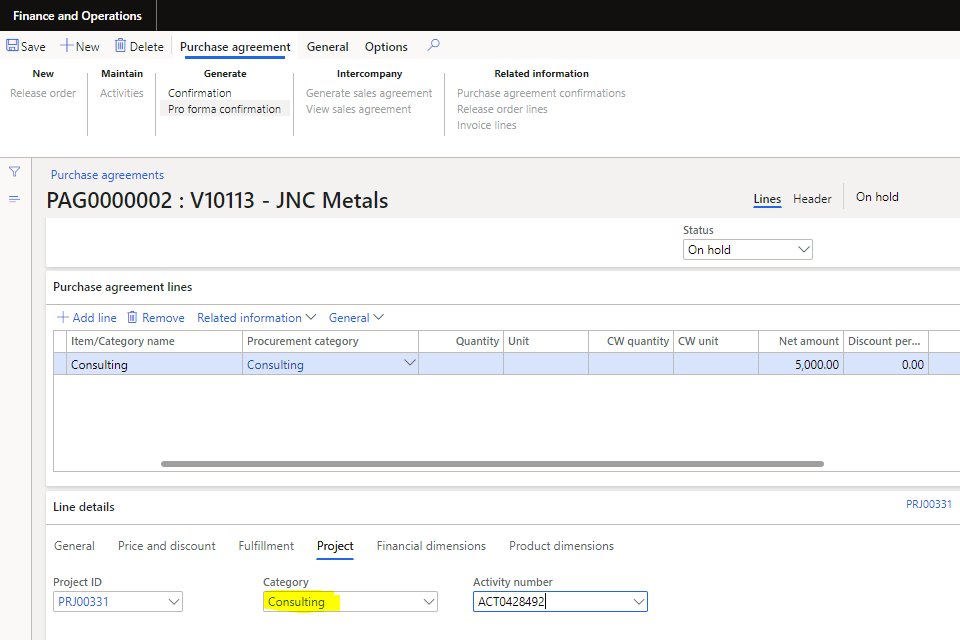

      I create a Purchase agreement from a Project in Project Management, and use a corresponding Procurement Category:
      In line details, in the Project tab, I select the Category that I displayed in the first screenshot:

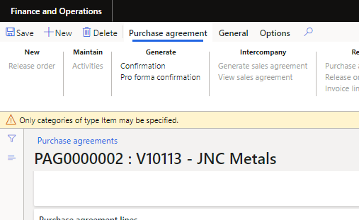

      However, when I try to save the Purchase Agreement, I receive the following error:

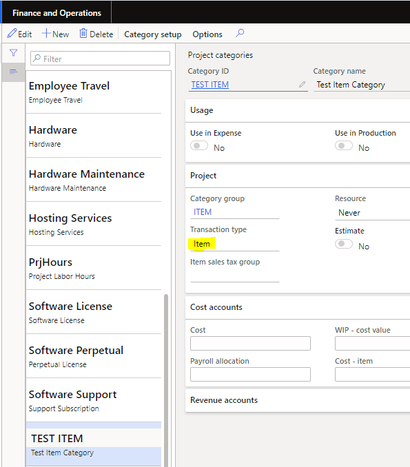

      I set up a Test category that is set up for “Item”, and that seems to work fine:

      The main thing to understand is that you cannot have the same category coding for item and expenses. There is separation between expense and item categories even though ultimately they are hitting the same accounts.
