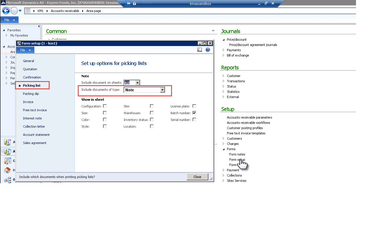

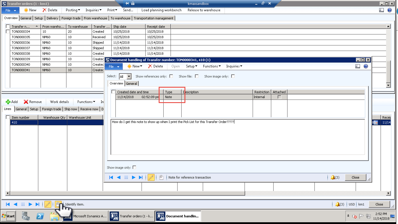

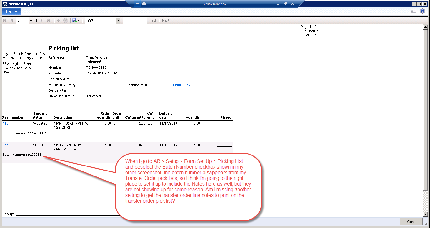

      ?Hey Guys-
      We’re using 2012 R3 CU11 and I want to print comments / notes on my Transfer order Pick Lists. In AR I went to the Form set up section and I have it set to include documents of type “note” and then I am adding “note” type comments on my Transfer order Line but they’re not showing up on the Pick List. I find it odd because even though I know this pick list form set up is more often thought of as being used for sales order picking, if I change other settings on it such as the show in sheet batch number checkbox that is selected in the image below, it does impact what gets displayed on the Transfer Order pick list, so why aren’t the Notes showing up?

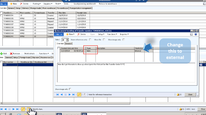

      Hello Amanda,
      See screen shot. I believe it has to be an external note to print. Hope this helps. Rob

    • Amanda Harris
      November 19, 2018 at 11:12 AM
      ?Hey Robert-
      Thanks for your reply. I tried your suggestion but unfortunately no luck. Any other ideas?
