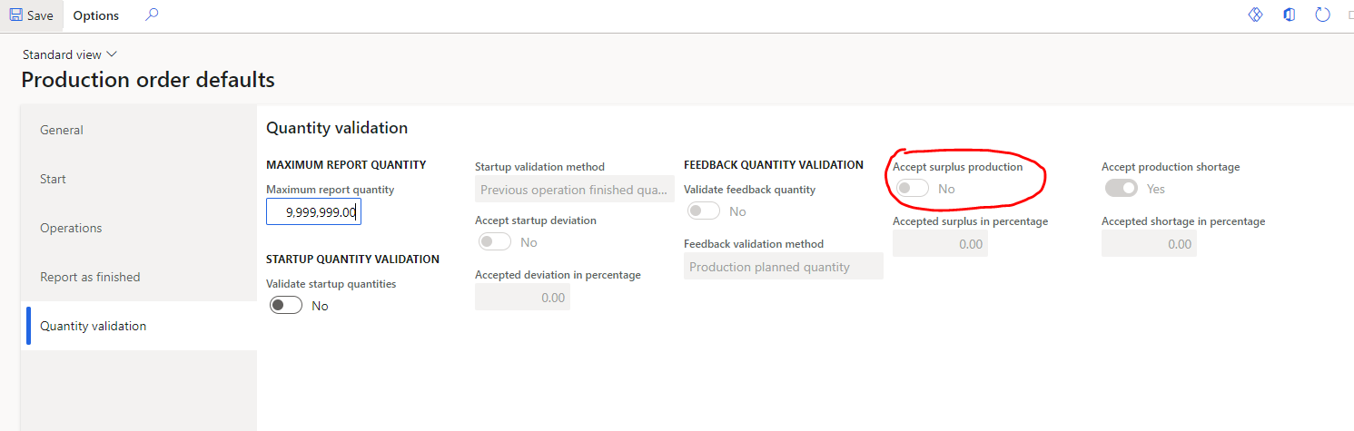

    • Samantha Mattson
      September 27, 2022 at 8:17 AM
      Patrick,Ā
      Do you have quantity validations configured under the production order defaults within the manufacturing execution setup?

    • Patrick Perlas
      September 27, 2022 at 12:42 PM
      Hi Sami,
      Thanks for your response!Ā  I’m assuming you want to see the setting for “Accept surplus production”, it is set to “No” (screenshot below).Ā Ā

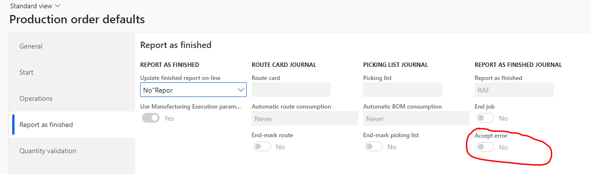

      Is there anything else I should look at?Ā  I also noticed that in the “Report as Finished” section, in the Report as Finished Journal, “Accept error” is set to “No”,
      however in the Production control parameters section, this is set to “Yes”
      Will this cause a conflict?Ā  On the journals I’ve looked at, Accept error is set to “Yes”, so I guess it’s pulling from Production control parameters for it’s default.

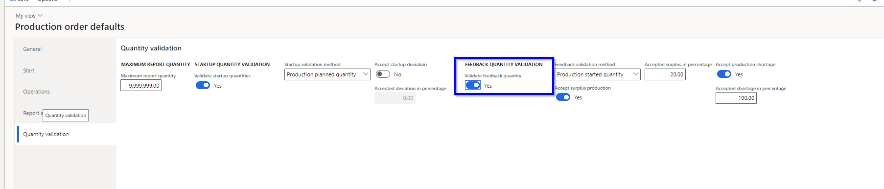

    • Samantha Mattson
      September 27, 2022 at 12:57 PM
      Patrick,Ā
      you should be able to toggle the validate feedback quantity to yes and then you can choose how you want the system to validate the quantity.Ā
