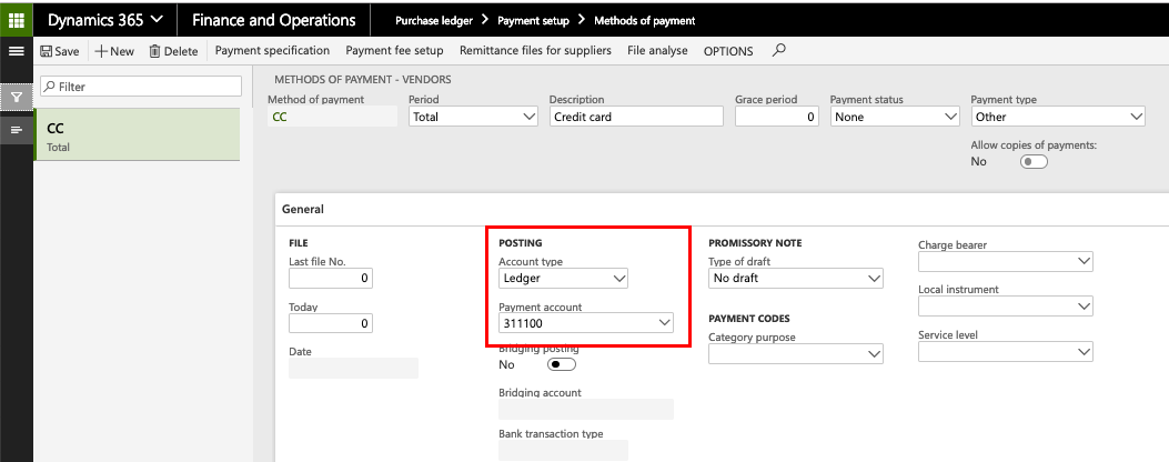

      Assuming you pay the supplier (Amazon) immediately with a company Credit card, and then pay off the Credit Card at a later date, this can be easily accommodated through the use of Methods of Payment in the Purchase ledger.
      You should set up these suppliers with a Credit Card Method of payment, which has an offset account that will post to a Credit Card ledger account.
      When the invoice is processed through FinOps it can be picked up on a Payment Journal which would Debit the Supplier account then Credit the account defined on the Method of Payment.
      Once the Credit card statement is received, you will be able to reflect the Credit card payment in the Purchase ledger by creating a journal which Debits the Credit card account and Credits the Bank account.
