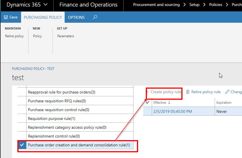

      Do you have any Procurement policies created? For purchase requisitions, it’s possible to create a Procurement policy with a rule against it that automatically splits orders if lines have different requesters, line types, or procurement categories.
      For example, after I create a rule, I can assign a policy rule type to apply to it:

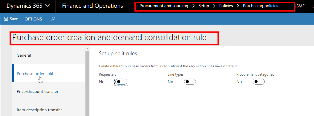

      once the policy rule type is added, it can be configured for order splitting:
      These can be setup in Procurement and Sourcing > Setup > Policies > Purchasing policies (may still be called Procurement policies in AX2012, I’d have to check).Ā
