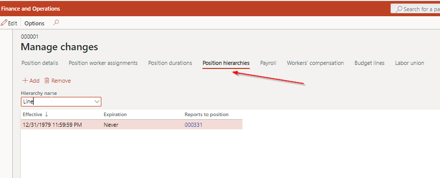

      In the positions that won’t delete, in the manage changes menu for those positions there should be a tab called Position hierarchies, can you see if there is something there. a lot of these records are date effective so even though nothing shows up currently there might be historical ties. SorryĀ  I don’t have an ax 2012 screenshot to show you but should be the same as D365

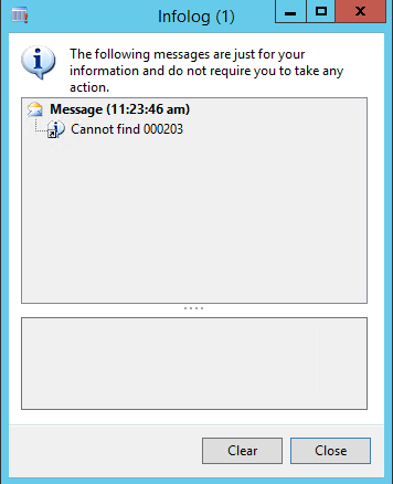

      When opening ‘View In Hierarchy’ from the Position screen, this is what is returned.
      Mark Yankovich

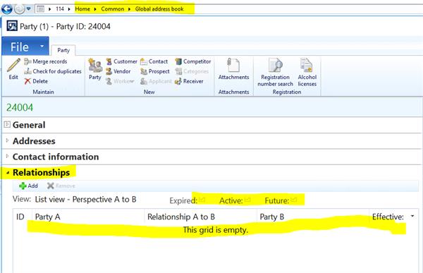

      These relationships may show up as Party relationships. Thus, you may be able to view & edit them by going to the Party, scrolling down to the very bottom, and reviewing the relationships there.Ā

    • Mark Yankovich
      August 28, 2020 at 9:10 AM
      Tony,
      Not finding it there.Ā  But it may be more due to unfamiliar with how I would find the position.Ā  All we have to go in is the Position ID of 000203.Ā  Any tiips?

    • Mark Yankovich
      August 31, 2020 at 10:35 AM
      Tony,
      That helped.Ā  It was not found the the HcmPositionHierarchy (as it appears to reflect the current state hierarchy).Ā  Looking at the other HcmPosition tables led us to HcmPositionDetail where we found position 000209 had reported to position 000203 and had 2 records – an older record with a valid start/expiration dates that reported to 000203, the other was the current state which reported to another position.Ā  We then went back into the HR module in AX, opened position 000209, ‘Maintain Versions’ and clicked the ‘Position Hierarchies’ tab.Ā  This displayed the older record and the current state record we saw when looking in the table.Ā  Since we are cleaning up our structure, we ‘Removed’ the ‘Position Hierarchies’ record that reported to position 000203 and were then able to delete position 000203.
